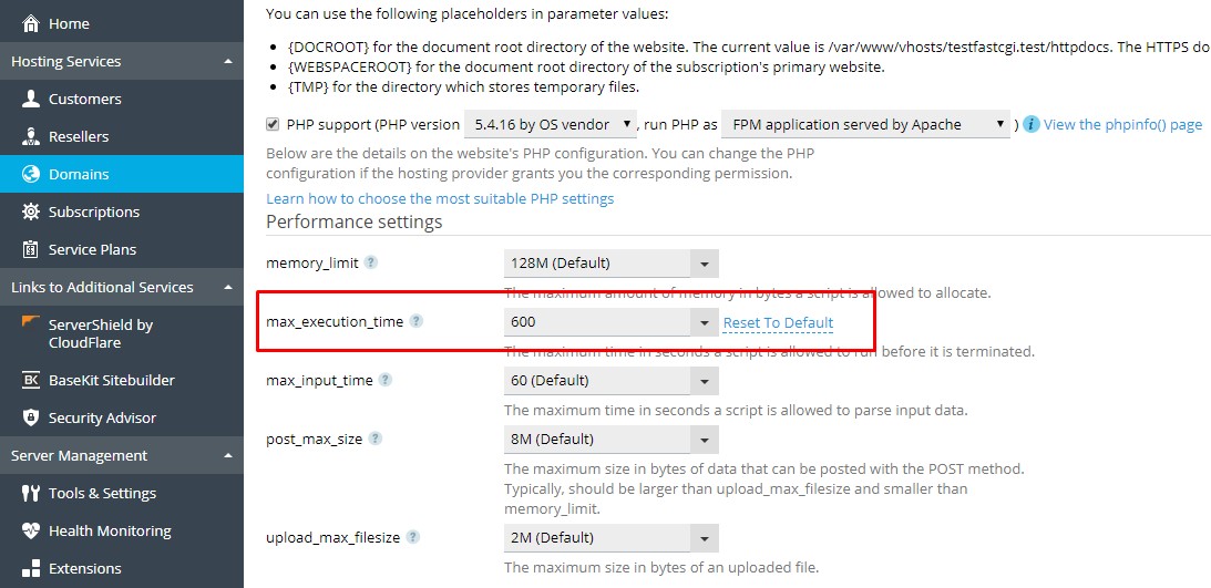

Via PHP Settings
Note: The same configuration can be applied at the service plan level in Plesk > Service Plans > Service Plan Name > PHP Settings
  1. Log in to Plesk GUI
  2. Go to Domains > example.com > PHP Settings > Change max_execution_time to configure proxy_read_timeout > Click OK to apply the changes:

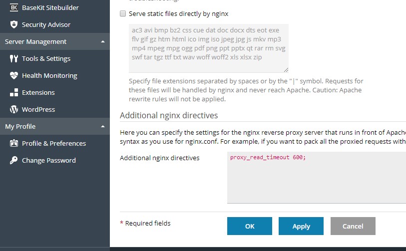

Via Additional Nginx Directives
Note: The same configuration can be applied at the service plan level in Plesk > Service Plans > Service Plan Name > Web Server
  2. Go to Domains > example.com > Apache & Nginx Settings > Additional Nginx directives > Add the proxy_read_timeout directive > Click OK to apply the changes. As an example:
    CONFIG_TEXT: proxy_read_timeout 600;
