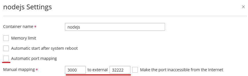

  3. Go to Docker > select a container > Settings icon (on the right) > Uncheck the Automatic port mapping box and map the port inside the Docker container to an external port on the virtual server host system (for example, 32222) manually:
    Note: In the example above, both ports 3000 and 32222 are managed by Docker, thus incoming requests received on port 32222 will be forwarded to port 3000 on your Docker container via the Docker proxy automatically.

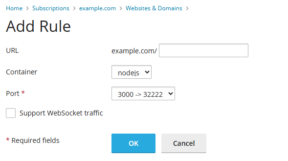

  4. Go to Domains > example.com> Dashboard > Docker Proxy Rules > Add Rule and set up nginx to proxy requests that are incoming via domains on ports 443 and 80 to that external Docker port (32222 in the example above) by specifying the following:
    • URL - Specify the URL of the website that uses an application running in a Docker container. It can be either the main website or a part of it.
    • Container - Select the name of the Docker container that should be served via the domain
    • Port - Select the port mapping combination that you have specified in the Docker container settings. The nginx web server will proxy requests that are incoming on ports 80 and 443 towards the external Docker port (32222 in this example), which is automatically proxied to the internal Docker container port (3000 in this example)
Once all of this is done, you should be able to view the Docker container website content while visiting the domain.
