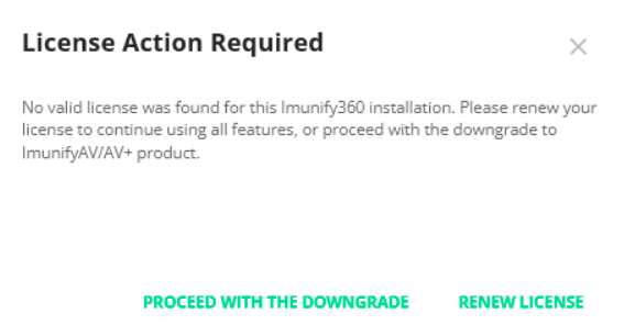

  • The Imunify, ImunifyAV or Imunify360 extension for Plesk cannot be activated, while a popup that is similar to the following appears when you press on Imunify within the Plesk GUI:
  • One of the following error messages is shown when accessing the Imunify extensions in Plesk:
    PLESK_ERROR: Servers limit exceeded for key <KeyNumber>
    CONFIG_TEXT: No valid license was found for this Imunify installation. Please upgrade your license to continue using all benefits of the Imunify.
    CONFIG_TEXT: WARNING: {"message":"(#_#) You can not register a new server! Right now you have 1 server and your license limit is 1.","type":null,"success":false,"data":null}
  • The following warning is shown while attempting to install the extension manually via command line:
    CONFIG_TEXT: WARNING: License is invalid for current server
    Register by IP...
    CONFIG_TEXT: WARNING: {"message":"Servers limit exceeded for key IY1ghpLItqZE8RQbV","type":"validation","success":false,"data":null}
    Registration was not successful.
