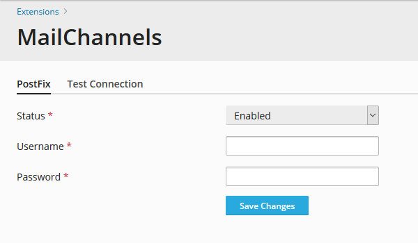

The "MailChannels SMTP Relay" Plesk extension is not configured.
Resolution
  1. Log in to Plesk.
  2. Remove or configure the extension.
    • To remove the extension, go to Extension > My Extensions > MailChannels SMTP Relay > Remove.
    • To configure the extension, open it and specify "Username" and "Password" in the fields.
