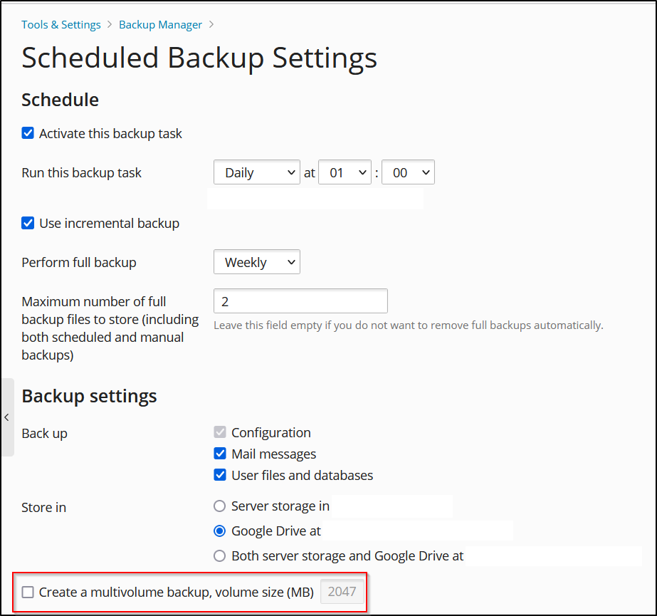

Workaround
In case the update is not possible for some reason use the following
workaround
Disable the Create a multivolume backup, volume size (MB) option in backup task settings:
