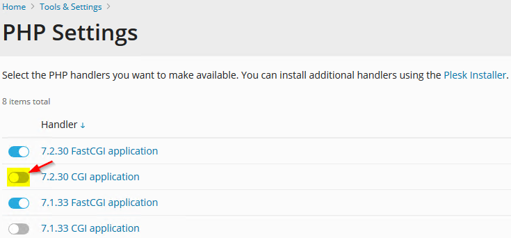

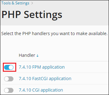

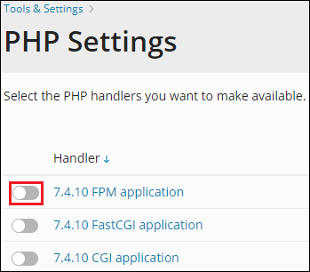

  1. Log into Plesk.
  2. Go to Tools & Settings > PHP Settings.
  3. To enable: move the slider to the right in front of the required PHP handler:

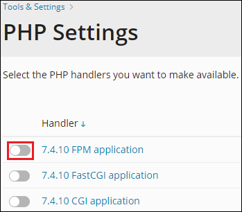

    To disable: move the slider to the left in front of the required PHP handler:
    Note: in the case, the required PHP handler is missed, install it using the steps from this article.

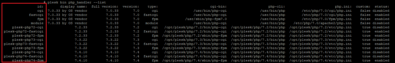

Solution using the SSH access
  1. Log into the server via SSH.
  2. Execute the command below to list all installed PHP handlers:
    # plesk bin php_handler --list
    The result will be as on the screenshot below:
    Click on the screenshot below to expand

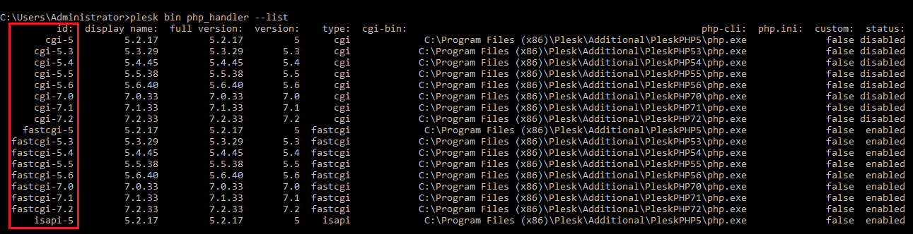

Solution using the RDP access
  1. Log into the server via RDP.
  2. Start a command prompt as an Administrator.
  3. Execute the command below to list all installed PHP handlers:
    C:\> plesk bin php_handler --list
