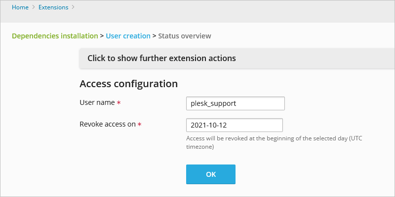

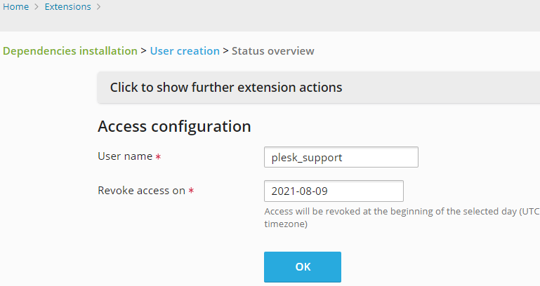

  1. Log into Plesk

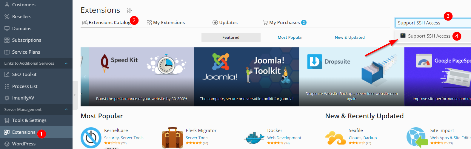

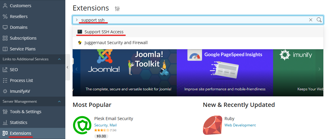

  2. Search for Support SSH Access
  3. Install and open the extension

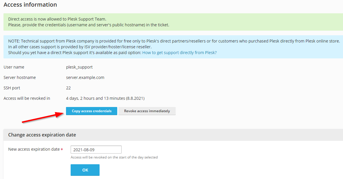

  4. Press Save to create the credentials
  5. Copy access credentials and send them to a Plesk Support representative in a ticket or chat
Note: The extension uses SSH keys, so it won't share sensitive credentials, only the username and server hostname.

  • Do we have to generate a password for the user plesk_support ?
    1
    • How to create a password for plesk_support
      I have installed Plesk Support via SSH. The user plesk_support will be created, but there will be NO password shown. Even if you go to Extensions > Support Access and click "copy access credentials". According to the support chat, this is expected. Don't worry about the "username : password" field in the ticket submission form.
