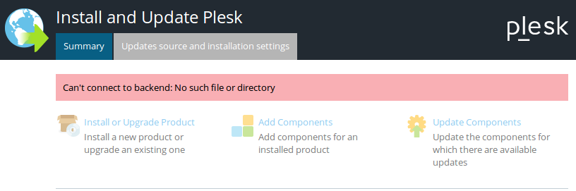

Symptoms
When trying to open the menu Tools & Settings > Updates (or Updates and Upgrades) on a Plesk for Linux server, the following error is shown:
Can't connect to backend: No such file or directory
Cause
The package psa-autoinstaller is corrupted.
