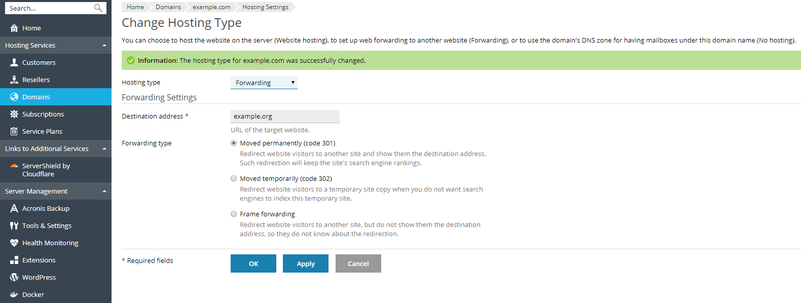

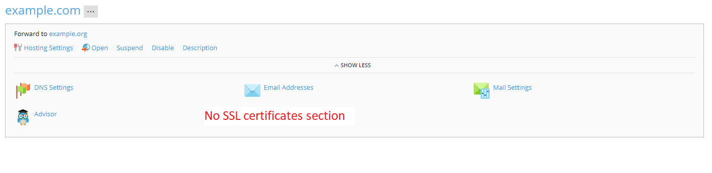

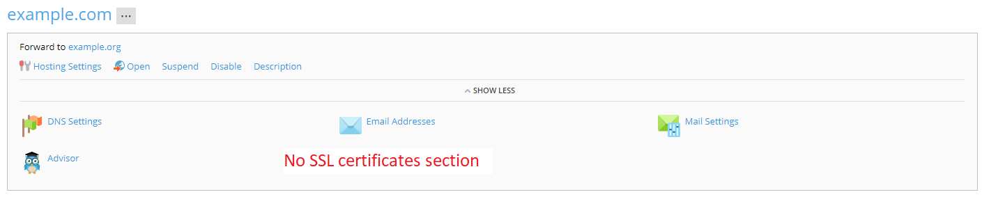

How to allow HTTPS and configure an SSL certificate on a domain in Plesk which has Hosting Type set as Forwarding in Domains > example.com > Hosting Settings?

Check if the Common Challenge directory is enabled on the server.
If the output of the command is as below:# plesk ext sslit --common-challenge-dir -info
- Available: true
- Enabled: falseExecute the next command to enable the Common Challenge directory:
# plesk ext sslit --common-challenge-dir -enable
Go to Domains > example.com > SSL/TLS Certificates where
example.com
is a domain with hosting type Forwarding and install a Let's Encrypt or the certificate from 3rd party certificate authorities.To secure a Forwarding hosting type domain with a free Let's Encrypt certificate via CLIuse the below command:
