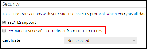

The option Permanent SEO-safe 301 redirect from HTTP to HTTPS is enabled in Domains > example.com > Hosting & DNS tab > Hosting Settings.

Temporarily disable the option Permanent SEO-safe 301 redirect from HTTP to HTTPS in Domains > example.com > Hosting & DNS Settings tab > Hosting Settings:

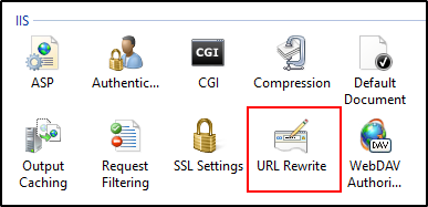

Connect to the server via RDP and disable all HTTP<->HTTPS rules in IIS Manager at Server > Sites > example.com > URL Rewrite:
