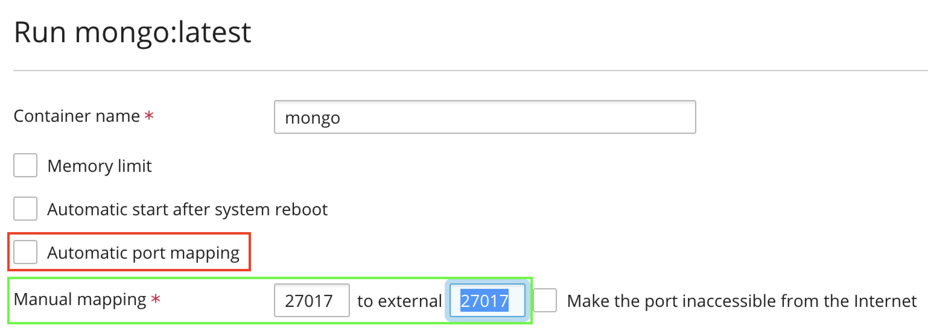

  6. Disable Automatic port mapping and manually map MongoDB instance to the desired localhost port:
    Note: External port is the port on which all connections to MongoDB will be served.
    Warning: If port mapping is configured, Docker binds to the specified port on all network interfaces of the host system. This means the MongoDB instance will be accessible from anywhere, and additional firewall rules should be created to limit access if necessary.

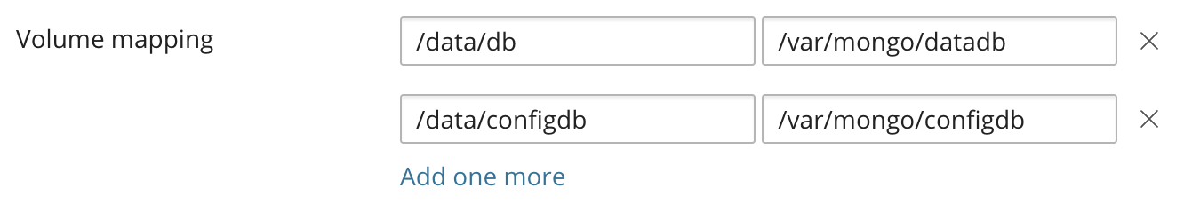

  7. Map Docker container paths /data/db and /data/configdb to the preferred location on file system to ensure that both data and configuration will survive Docker container restarts and be accessible:

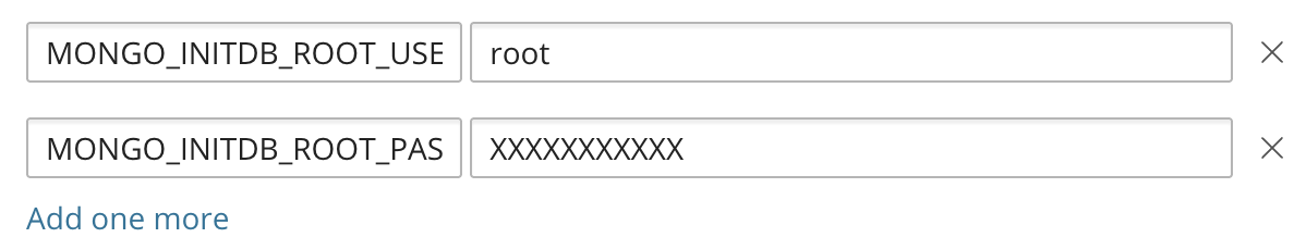

  8. Add the variables MONGO_INITDB_ROOT_USERNAME and MONGO_INITDB_ROOT_PASSWORD to be able to change root password:
