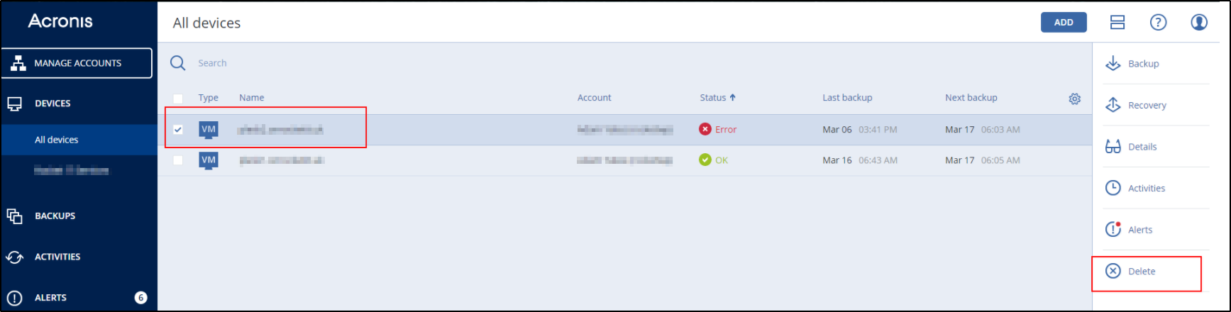

  1. Log in to Backup Console directly via cloud.acronis.com
  2. Delete the affected Plesk Server from the console (backups will not be deleted):
  3. Connect to the server via SSH
