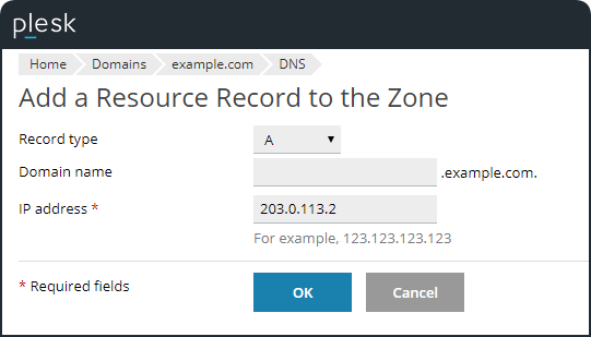

If DNS is managed in Plesk:
  1. Log into Plesk;
  2. Add record (type A) for the example.com in Plesk > Domains > example.com > DNS Settings > Add Record:
  3. Click OK.
