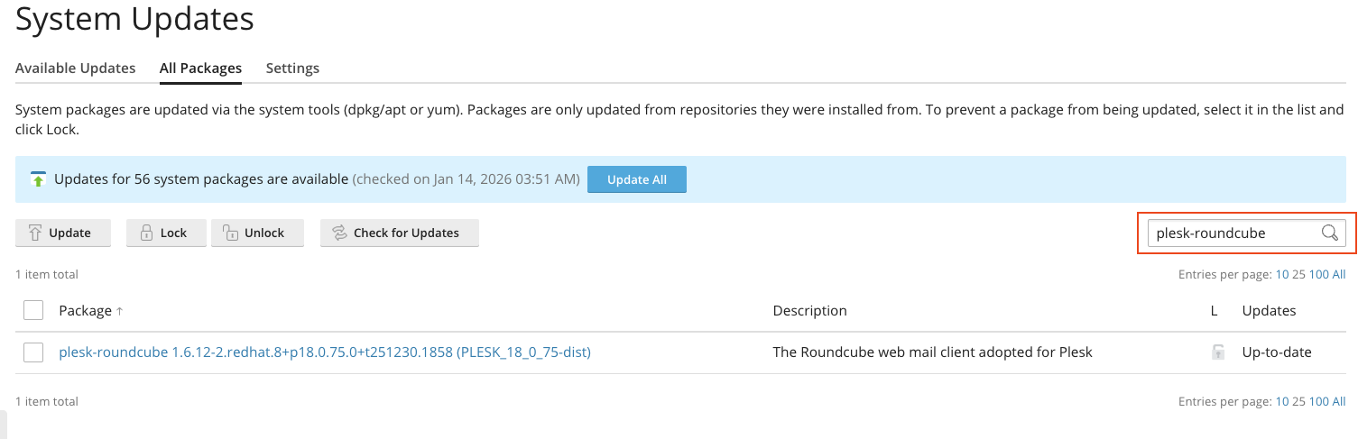

  3. Search for package(s) that should be excluded from update:

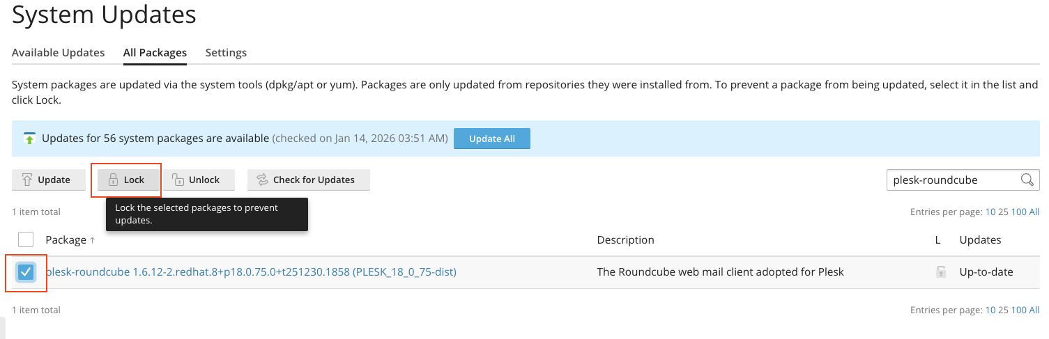

  4. Select the package(s) using the check-box and click Lock:
  5. In the confirmation window, click OK.

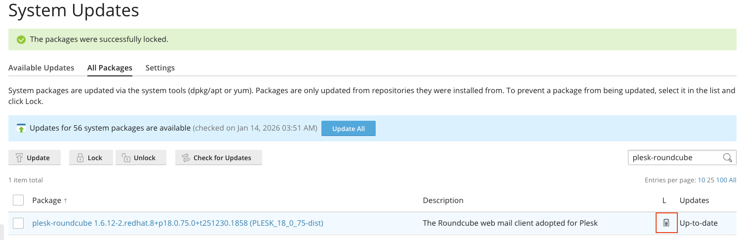

    Packages that have been prevented from updates will now be marked with a grey lock:
