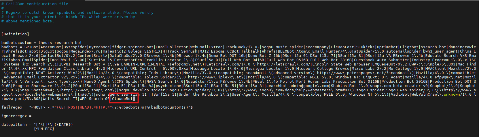

  3. Edit /etc/fail2ban/filter.d/apache-badbots.conf file and add the required bot.
    In the example below ClaudeBot is added:

  • Please add a copy and past line for badbotscustom = examplebot|examplebot| to the explanation - Not just a screenshot
    0
  • Hello Thomas,
    This article describes where users can put their own custom values. The ones on the screenshot are just an example and should not be copied.
    0
