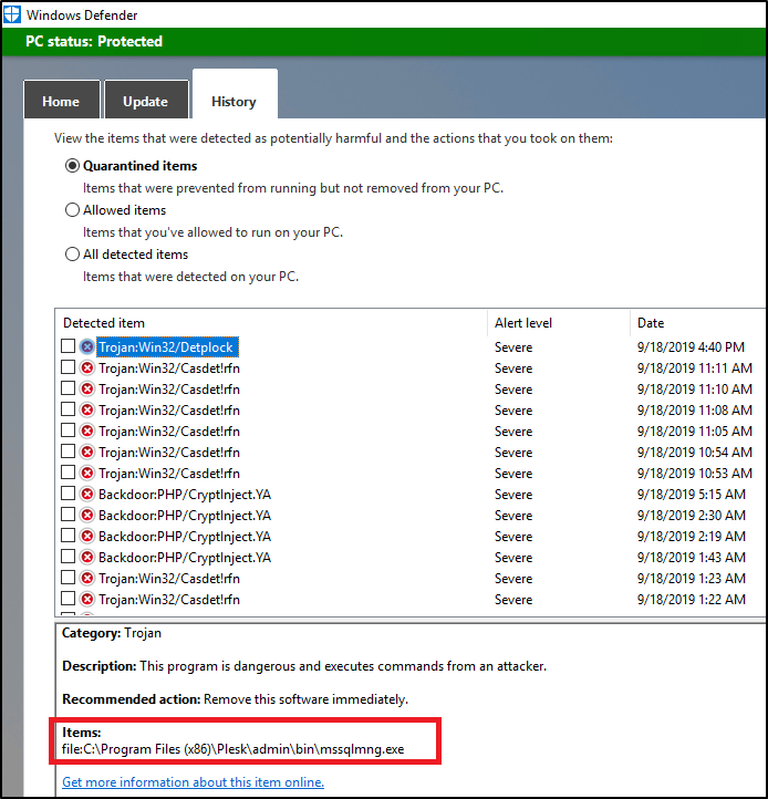

Situation
  • mssqlmng.exe, DNSMng.exe, php.exe,pmm-ras.exe, nssm.exe and/or pleskstartup.exe utilities are shown as infected by Trojan:Win32/Detplock on Windows Defender:
It is a false-positive detection by Windows Defender antivirus. This has been registered as a security issue with ID PPPM-11032.
  • The following error message might be shown in Tools & Settings > Database Servers > <MS SQL Server name>:
    Error: The test connection to the database server has failed because of network problems:
    mssqlmng failed: plesk_exec_with_response("C:\Program Files (x86)\Plesk\admin\bin\mssqlmng" --check "--server=example.com,1234" "--login=john_doe" "--password=******) failed: Unable to execute plesk_exec_with_response: Unable to start ("C:\Program Files (x86)\Plesk\admin\bin\mssqlmng" --check "--server=example.com,1234" "--login=john_doe" "--password=*")<br> at Plesk impersonation(PipeServer::ServerThread::simpleRunAs line 687)<br> at (zif_plesk_exec_with_response line 1135)

Impact
Files can be automatically removed/quarantined by antivirus, preventing the normal functionality of Plesk services.
Call to action
Until the issue is resolved, add the directories containing Plesk executable files to exclusions on Windows Defender:
