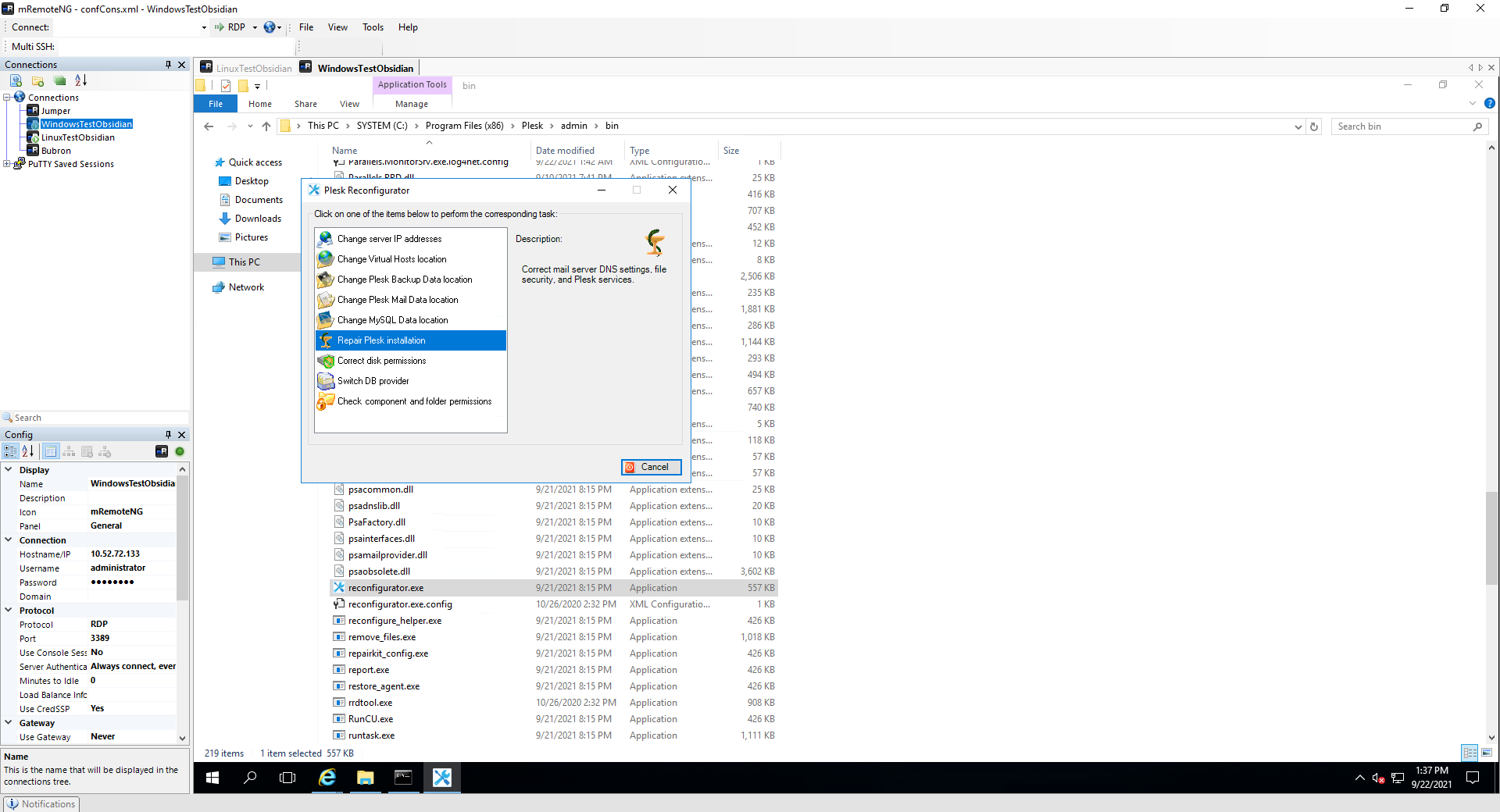

  2. Open reconfigurator.exe file in %plesk_dir%admin\bin directory.

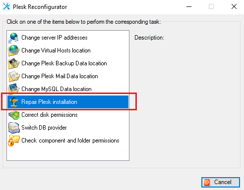

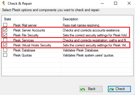

  3. Press Repair Plesk installation:

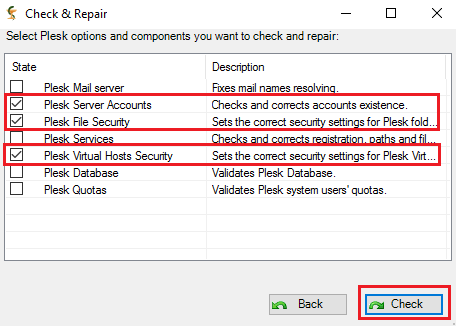

  4. Select the Plesk Server Accounts, Plesk File Security and Plesk Virtual Hosts Security options and press the Check button:

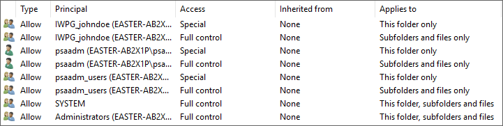

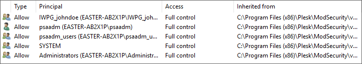

  5. Right-click logs directory > Properties > Security > Advanced > Permissions and set the same permissions as in the following screenshot:

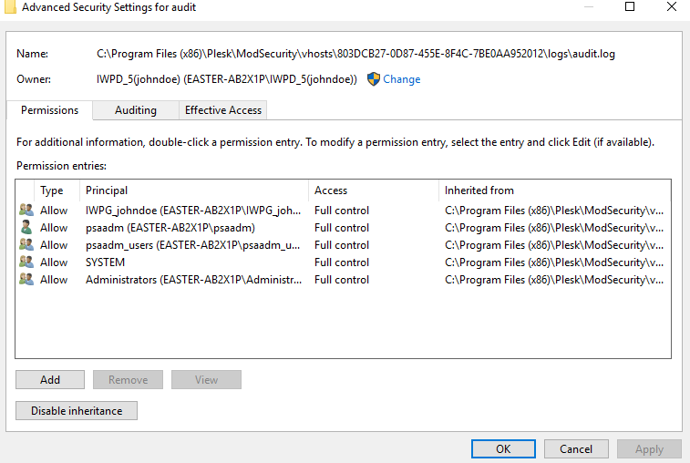

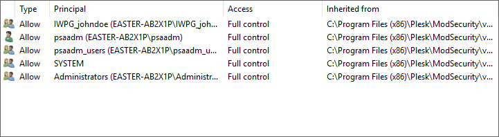

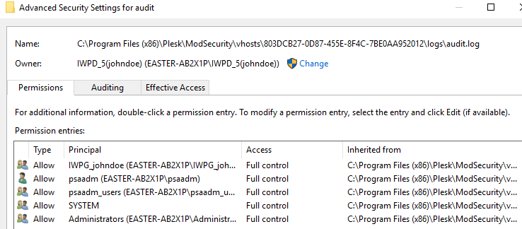

  6. Open the logs folder within the same directory, right-click audit.log file > Properties > Security > Advanced > Permissions set the permissions as below:
    Note: in the examples above instead of IWPG_johndoe should be the system user of the affected subscriptions.
