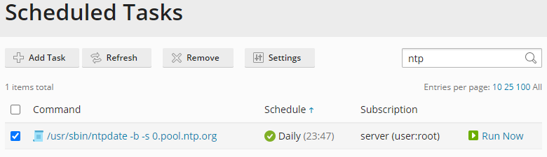

  1. Log into Plesk
  2. Navigate to Tools & Settings > Scheduled Tasks (Cron jobs)
  3. Select the scheduled task /usr/sbin/ntpdate -b -s [n].pool.ntp.org:
    Remove ntpdate scheduled task
  4. Click Remove
