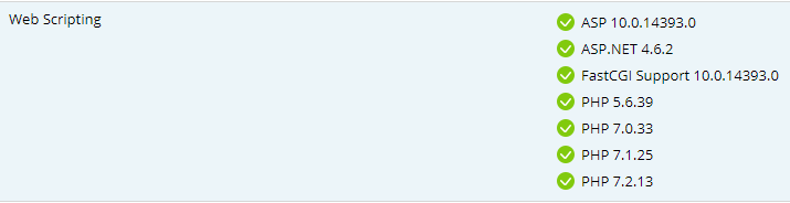

  • If there is no Python and/or Perl in Tools & Settings > Server Components > Web Scripting, no additional actions need to be taken:
  • If there is Python and/or Perl in Tools & Settings > Server Components > Web Scripting, additional actions should be taken:

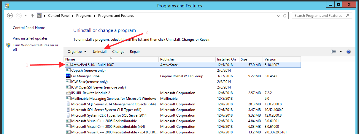

    How to remove ActivePython and ActivePerl from a Plesk server?
    Warning: Removing ActivePython and ActivePerl from the server with Plesk 12.0 will make SpamAssassin and AWStats stop functioning. To prevent such a situation upgrade Plesk from 12.x to the latest release.
    1. Log into Plesk
    2. Disable the Perl support and Python support options for all existed service plans in Service Plans > Service_Plan_Name > Hosting Parameters.
      Warning: this is a mandatory step: otherwise, handlers will not be removed from domains settings.
    3. Connect to the server via RDP.
    4. Go to Start > Control Panel > Programs and Features.
    5. Select ActivePerl or ActivePython and click the Uninstall button.
