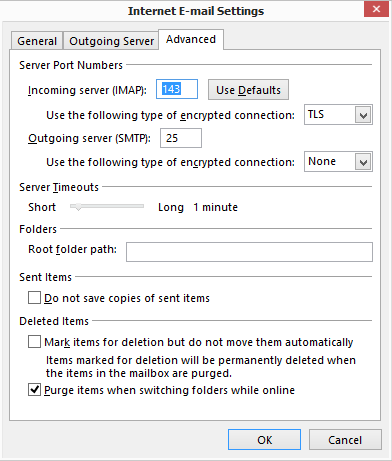

Make sure that Outlook has got the following configuration in Outlook > File > Account Settings > Account Settings > jdoe@example.com > Change.. > More Settings:
