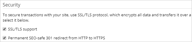

Enable the option Permanent SEO-safe 301 redirect from HTTP to HTTPS at Domains > server.example.com > Hosting Settings:

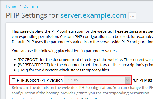

Un-check PHP support at Domains > server.example.com > PHP Settings and apply the changes.
