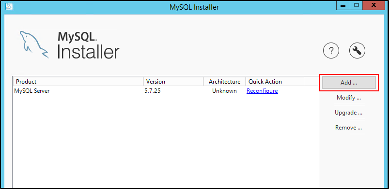

Press Add ... button.
Add MySQL server to the installation.
Proceed with the installation.

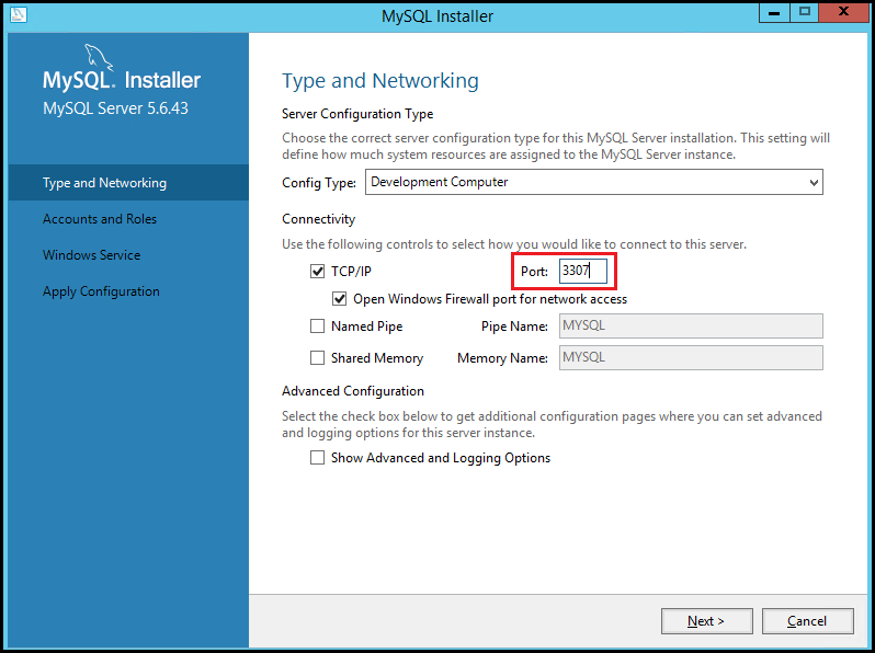

Specify TCP/IP port different from
3306
as it is used for MySQL server shipped with Plesk.Warning: MySQL servers do not work at the same time if they use the same configuration file and the same port.

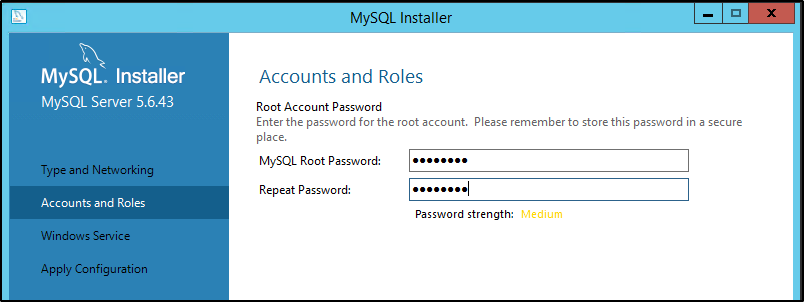

Specify MySQL Root Password.

Make sure that port
3307
is specified inmy.ini
configuration file for the second MySQL server installed. Default file location is Use file located inC:\ProgramData\MySQL\MySQL Server X.X\my.ini
:CONFIG_TEXT: port = 3307

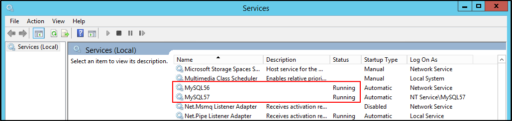

Execute the command below in Command Prompt and open Windows Services:
C:\> services.msc
Make sure that there are two MySQL services running.

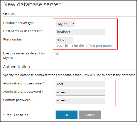

Go to Tools & Settings > Database Servers > Add database server .
Select MySQL in Database server type , specify a Host name or IP address, Port number and Authentication data of another MySQL server.
Note: By default, Administrator's username for additional MySQL server is
root
