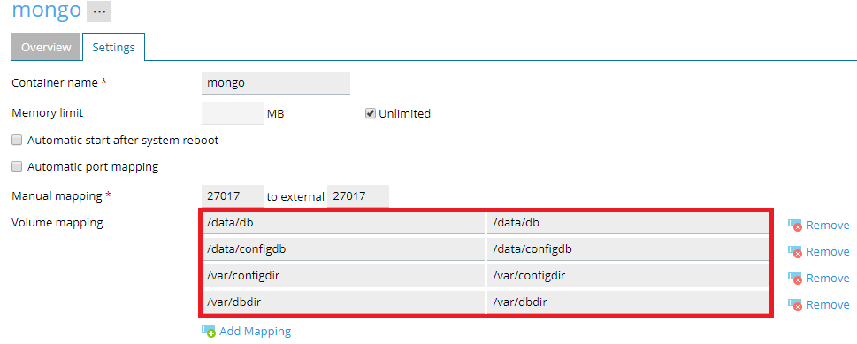

Map Docker container to location on file system, to ensure that both data and configuration will survive Docker container restarts:
