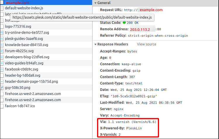

Open the website via browser and check the headers of the page using browser's dev tools. Varnish header should be displayed:

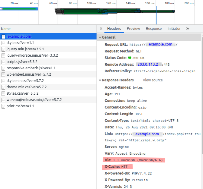

Open the WordPress website using the browser's developer's tools (Network tab) and verify that the varnish cache is being loaded:
